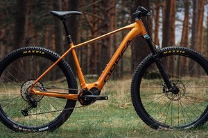

Orbea Urrun (2023) - Geometry
Compare these geometries with each other
Die Tabelle lässt sich verschieben.
Modell Orbea Urrun (2023) Orbea Urrun (2023) Orbea Urrun (2023) Orbea Urrun (2023)
Frame Size/Setup S M L XL
Typ Mountainbike Mountainbike Mountainbike Mountainbike
Wheel Size 29″ 29″ 29″ 29″
Reach 395 mm 405 mm 440 mm 460 mm
Stack 631 mm 628 mm 647 mm 666 mm
STR 1,60 1,55 1,47 1,45
Reach+
Stack+
Front-Center
Head Angle 65.5° 66° 66° 66°
Seat Angle, effective 74.8° 74.6° 74.6° 74.5°
Seat Angle, real
Top Tube Length
Top Tube Length (horizontal) 565 mm 579 mm 608 mm 645 mm
Head Tube Length 110 mm 115 mm 132 mm 153 mm
Seat Tube Length 400 mm 453 mm 483 mm 533 mm
Standover Height 826 mm 854 mm 877 mm 910 mm
Chainstay Length 445 mm 445 mm 445 mm 445 mm
Wheelbase 1.143 mm 1.150 mm 1.173 mm 1.220 mm
FC2RC 1,57 1,58 1,64 1,74
Bottom Bracket Drop
Bottom Bracket Height 322 mm 320 mm 320 mm 320 mm
Fork installation height
Fork offset
Trail
Travel (rear) 0 mm 0 mm 0 mm 0 mm
Travel (front) 100 mm 100 mm 100 mm 100 mm
